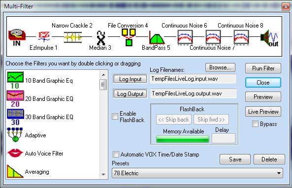

    I do not have time sync between the source and destination. I have the "sync" button on the toolbar pressed, but the files are off. Picture below. What can I do to sync them up ?

                              I have put the multifilter in the forum "preset" location as 78 Preset.
                              On my system, the delay is caused from this preset and is the picture at the first post.
                              The CNF has 8K/2K/2K
