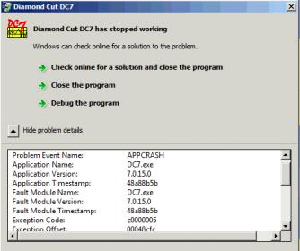

    Recorded a vinyl yesterday. Today when trying to edit any of the files, DC7 decides it is time to go home - msg 'DC7 has stopped working' + opitons to go online, stop now.
    Using Windows 7.
    Any ideas? thanks.

    Not sure what happened, but it sounds like something on your hard drive has gotten corrupted. Try uninstalling the DC7 software program and then re-installing it. If a sector on your hard drive has become defective, the above process will get around it.
      Thanks, Craig. Here is the error msg before and after re-install. The crash occurs when trying to set up the multi filter, after recording and trying to play the recording.

                          Does the system do anything at all? Does it record a file using the recorder? Can it process a file through a filter, one filter at a time? Or is it totally broken? Give me a few more hints as to what it does do (if anything).
                            It will record. Then when trying to use a filter/any filter the msg dc7 is not responding. If trying to play the msg 'DirectSound error:the specified wave format is not supported'.
                            And that is about where I am.
                            Thanks for all your help, Craig.
                            Kim
