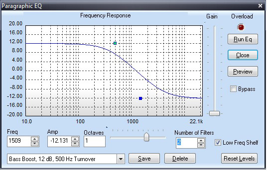

        The top frequency band on the paragraphic EQ is always a shelf; it is never a resonant filter. The bottom filter in version 8.5 can be converted from a 2nd order resonant filter into a shelf filter by checking the box. So, to create phonographic curves in the most accurate way, set the paragraphic EQ for only 2 filters. The right-most one will be the Rolloff portion of the curve (shelf) and the left-most one will be the Turnover portion of the curve. Only two shelving filters are needed to create any phonographic curve with the new system. With the old system (before DC8.5), it took many filters to create the various phonographic curves because it did not have the low frequency shelf filter. Once you have it set for those two filters, you can manipulate the curves to create any curve shape that you desire. Let me know if this clarification has been helpful.
          Here is a screen shot of a generic phonographic EQ curve using the paragraphic EQ. Note that 2 filters (only) are selected and that the Low Freq Shelf is checkboxed.

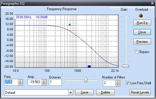

                        I just looked at the original problem posted here on this thread involving creating the NAB Phono EQ curve. I looked at the response of the Virtual Phono Preamplifier Preset titled "Approximate NAB LP Curve" and used the spectrum analyzer to measure its accuracy. It is roughly 0.3 dB off at 10 kHz. That is well beyond the capability of human hearing in terms of error to be detectable and substantially beyond the accuracy of the encoding equipment that created that curve when they cut the record master with analog filters.
                          Here is a rolloff curve using the double-shelf (2 inflection points) of the paragraphic EQ. This curve has the rolloff characteristic of the NAB curve and has an attenuation factor of -16 dB @ 10,000 Hz.

                            Since you posted the image with the NAB curve, I will go with that. I see how the Rolloff is -16 dB @ 10,000 Hz. For NAB, the Turnover is 500Hz. What in the image above is showing me your Turnover is at 500Hz?
                              I did not set it for a specific turnover - - - just took one of the factory defaults and modified it for a NAB Rolloff. However it does appear that it happens to be set for around around a 400 Hz turnover setting (which is not quite correct for NAB - needs to be moved up to 500 Hz). My focus was on the Rolloff portion of the curve since I thought that was the major issue.
                              ps - it looks at close inspection to be off by around 1 dB at 500 Hz, but correct for 400 Hz.
