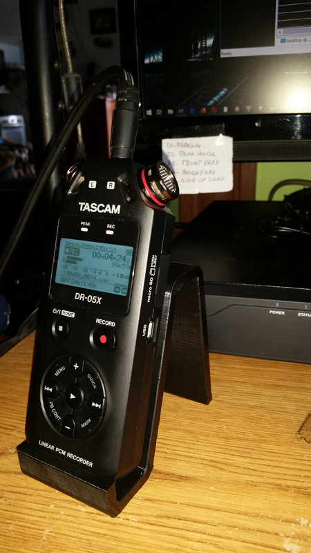

          Hello I'm resurrecting this thread to ask a question about flat recording. I record onto a TASCAM DR05X digital recorder using the mic input. I have to attenuate the signal from my pre-amp due to the TASCAM not being a line level device. I have plugged the TT directly into the recorder, recording to disk and then transferring the file to my workstation to eq in DCart10. I have plenty of gain with the TASCAM so S/N is not an issue. The cartridge is a Denon DL110. I've done a couple of records this way and do not discern any dulling of the signal, but that might be my hearing. I can post a snip of what I have recorded.
          The question is the REK O KUT sold here is a line level out device and I will need to attenuate to input into the TASCAM, even in flat mode, correct? REK O CUT also sells a switch box that will connect a TT to a phono input. Am I to assume the cartridge will still not see the proper loading if I put this in line with TASCAM? It works with either phono or standard line in.
          I *could* find a internal sound card to use, but I invested in this recorder when my old soundcard died. The attenuators are the bullet type, a -12 and -6 ganged.
          Thanks for your attention and any advice.

            The issue with going directly into the Tascam mic level input is the termination resistance of the Tascam. Usually, mic level inputs have around 10 kOhms terminations, but your phono cartridge likely is designed to operate with a 47,kOhm termination. If the cartridge is not properly terminated, the frequency response will not be what the company who made it says that it should be. If the loading is too low in resistance, the top end will be dull. The Rek O Cut preamp is a line level device. It will need an attenuator if you are to connect it directly to a mic level input. btw - I have a HD recorder here that I use, but it has a mic or line level input that can be selected. Are you sure your Tascam does not have that feature? You should only put an attenuator between a line output and a line input; never put it between the phono cartridge and any input on a soundcard.

              Craig:
              Yes, I am sure that it is only a mic input. There is no 20dB switch to attenuate the input. This is a 2 in/2 out handheld digital recorder 24/96 max resolution. I had the TASCAM plugged into the tape out of my pre-amp with the aforementioned attenuators.

              If an external audio device with a fixed output line level is connected, it might not be possible to control the gain level of excessively loud input signals. In such cases, use the headphone jack or other level-controllable output for connection to the unit.
              From other boards, I found out you can purchase an inline variable attenuator, volume control if you will, but I had already purchased the in-line attenuators. The headphone or variable out of the preamp would be fine, but I'll futz with the tone controls and I'd hate to forget to bypass.
              I'm leaning towards the REK-O-KUT and use the flat out for recording. Plus side, I can attach my semi-auto turntable I use for casual listening and have both TT plugged into the pre-amp. I would reconnect the recorder to the tape out for my needle drops.
              Thanks.
