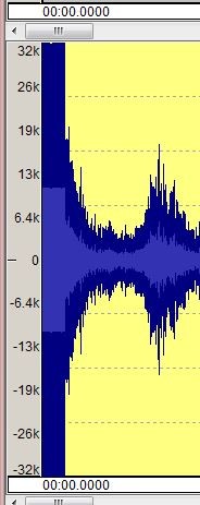

    When I use the tool I can get a loud "thump" at the beginning. Picture below. How to avoid this ?
      That is the system control loops initializing themselves. You can eliminate it after you are done using it by 'muting' that section of the tune.
