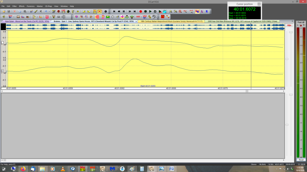

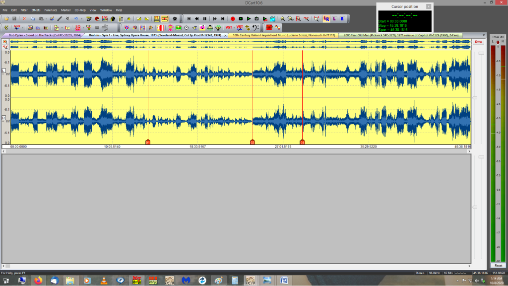

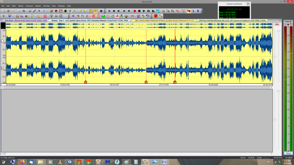

        For example, the attached screenshots show the results of -1 dB and -2 dB gain scaling on a live Brahms Symphony 1 LP. You can see that the music peak in the 4th movement overshoots the set levels in both cases: -1 dB makes the clip LED light and gives a slightly flattened waveform that touches 0 dB (see zoomed pic) and -2 dB gives a -0.7 peak. There's no audible distortion in the first case.
        With classical, these results are typical, or slightly better or worse. The screenshots show DC10 tabs for a few other LP's tested. The 18th Century Harpsichord album gave the same results as the Brahms. The Dylan album gave more accurate results (-1 dB gave -0.75) and the 2000 Year Old Man record overshot a little less than the classical (-0.3 and -1.1 dB respectively).

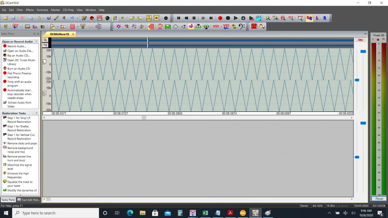

          Here is a 400 Hz triangle wave (created by the Make Waves Generator in the DC10.6x). It was recorded at - 10 dB and than Gain Normalized to 0.0 dB. Note that it precisely touches 0 dB:

            I just researched and then tested the main VU meter Clip LED. It is designed to trip on (red) whenever the signal exceeds -1.0 dB. I verfified that to be the case on DCArt10.62 using a triangle wave set to various values between -1 dB and 0 dB.

                Perhaps the term "overshoot" is unclear. I use it to refer to any gain scaling that overshoots the value I enter, not necessarily values that equal or exceed 0 dB or cause the LED to light. That's why I said "...overshoots the set level by 1-2 dB" in my first post. If I specify -2 dB (as I usually do), I expect that the file peak should be closer to -2 dB (as it is in DC7 and DC8) than 0 dB (as it is in DC10, depending on the type of music as I said). Yes, the peak in the right channel at 40:01 touches 0 dB, but that's not what I want when I specify -1 dB. I could've given you dozens of other examples of "overshoot" I've documented, these are just a few.
