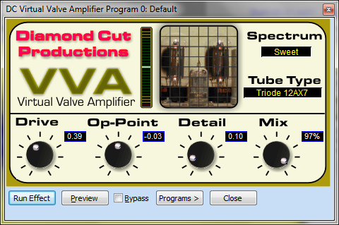

To use a VST plugin, just go to the Effects menu and then click on one of the populated VST Plug-ins slots. A screen similar to the one shown here will then appear. Like all of the Diamond Cut Software tools, you have the standard “Run Effect”, “Preview”, and “Close” buttons available.
A VST Plugin launched in Diamond Cut Forensics10

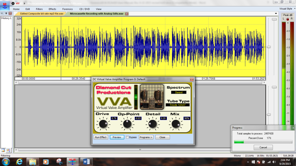

Once you have added tools you can enable them for actual use by double clicking on the desired plug-ins. Clicking on a tool will bring up that specific plug-in’s graphic controls. It can then be dragged and placed anywhere on your workspace. Chaining of VST Plug-ins is possible using the Diamond Cut Multifilter. Since VST Plug-in tools are written by programmers other than the authors of DC Forensics10, we can’t predict what you will ultimately see on the multifilter screen.
Usage from this point forward is like any other built in tool with DC Forensics10; just preview and adjust or run the VST filter or effect to suit your needs.

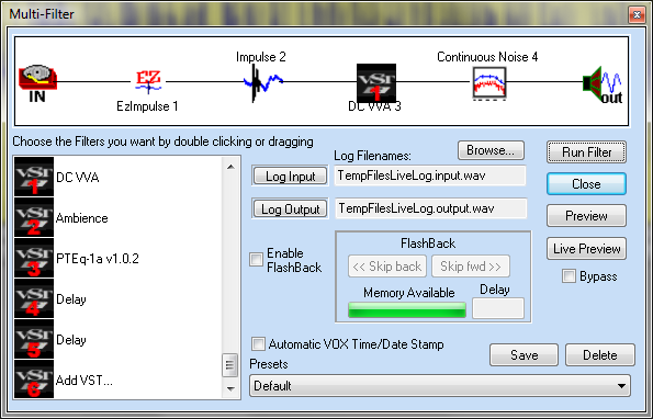

Using VST Plug-ins in the Multi-Filter
VST Plug-ins Integrate into the Multi-Filter
As can be seen above, the new VST icon(s) are available in the Multi-Filter so that these types of tools can be freely used with all the native DC Forensics10 tools. Please see the section in the users’ manual describing the Multi-Filter topic for specifics on the use of these tools when cascaded with others.
