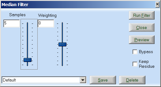

The following is a summary of the control parameters and range of adjustment provided for the Median Filter:
- Samples: 3 - 20
- Preview Mode Button: On / Off (The slider control can be adjusted "live" when the preview mode is on.)
- Weighting: +/- 100 (%) from the neutral value of 0. (0 provides no weighting to the Median value calculated by the filter.)
- Bypass Button: Allows you to compare between the filtered and the raw signal.
- Keep Residue: Allows you to hear what the Filter is removing from the raw signal.
Note 2: Best results on Forensics files will be had when they are first converted to a 44.1 kHz sample rate.
Median Filter Operating Procedure (Tutorial)
- Highlight the portion of your .wav file on which you desire to apply the Median Filter.
- Click on the “Median Filter” (Filter Menu).
- Choose the number of samples over which you desire the median calculation to be performed. The higher the number of samples selected, the greater will be the attenuation of the higher frequency portion of the audio spectrum. You can choose any integer value from 3 to 20 samples. (The most useful values will be found in the 3 to 7 samples range.) The higher the chosen number of samples, the longer will be the process time requirement for the algorithm. Changes in value are accomplished utilizing the slider control.
- If you desire to hear the results of your filter settings before creating a new "Destination" file, click on "Preview".
- You will hear the effect of the calculation of the median value over the chosen number of "samples".
- As the filter is running in either preview mode or normal mode (Destination File Mode), you will see a dialog box that indicates the "% Done" of the filter algorithm on the selected portion of the Source .wav file. Also, at the top of the Dialog box you will see indicated the "Total Samples to Process:"
- Keep adjusting the number of samples until you achieve your desired effect.
- When you are satisfied with a setting, click on “Run”, and the filter will process your source .wav file through the filter algorithm, and create a Destination .wav file containing the output of the filter.
- When this process is complete, you will see the Destination File become highlighted in Yellow, at the same time that the Source File becomes unselected.
- Click on "Close".
Note: The “Weighting” control is used to affect the Timbre of the resultant sound of the Median filter.
