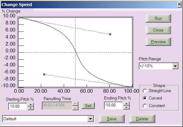

    The Change Speed Effect
    The following is a summary of the control parameters and the range of adjustment provided for the Change Speed filter:
    • Starting Pitch Control: -50% to +100%
    • Ending Pitch Control: -50% to +100%
    • Display Pitch Range (3 ranges):
      1. +/-1%
      2. +/-10%
      3. +100 / -50%
    • Shape (Pitch vs. Time):
    Straight Line (2 Green Cursors)
    Curved Line (4 Green Cursors)
    Constant (Start and End Track each other)
    • Graphical linear or curvilinear Pitch inflection points (green square cursors on graph)
    The Graph shows you how you have programmed the speed to change as a function of the selected .wav file time axis. You can use the mouse to drag the two green cursors to establish the time relationship that you desire. Often, a flat line is appropriate; however, sometimes the speed of the cutting lathe would slow down towards the end of the recording. The reason this occurred is that some of the early recording lathes used wind up mechanical motors with governors rather than electrical hysteretic synchronous motors. To correct this defect, a pitch decrease (negative pitch slope) is necessary towards the end of the recording. When the curve shape is selected, two additional green cursors appear. The new green cursors can be moved both vertically and horizontally allowing you to create numerous curvilinear pitch vs. time relationships. Curvilinear correction is useful for fixing the speed of non-capstan based tape recordings that have been transferred using a capstan-based machine. It can also be used to create interesting special effects when used in conjunction with the looped preview or looped play mode.
