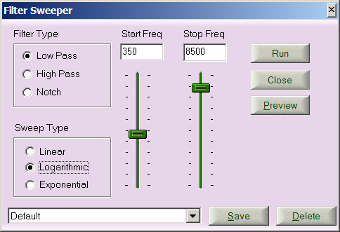

Filter Sweeper
The Filter Sweeper is a novel system providing a variable frequency response versus time capability. The sweeper can be applied to an entire .wav file or any portion by using the Diamond Cut selective filtering capability. Three filter types are available in the Filter Sweeper including a sweep-able Low-Pass, High-Pass, and Notch. Besides producing interesting special effects, the Filter Sweeper has a number of very useful audio restoration applications. Here are two examples.
The hum frequency of a recording sometimes changes as a function of time. This audio defect may be due to the fact that the original analog tape recorder was battery powered and as the battery became weaker during the recording process, its speed decreased. This mechanism will have caused the resultant hum frequency to increase versus time when played back later on a constant speed system. To correct this defect, you can apply the Filter Sweeper set for operation in “Notch” mode. Set the “Start Frequency” to the appropriate lowest hum frequency value of the defective .wav file, and the set the “Stop Frequency” to the highest value of hum frequency. These two values of frequency can be determined by using the Spectrum Analyzer while using the “looped play” mode during the appropriate sections (beginning and end) of the defective .wav file. The “Sweep Type” will need to be determined empirically, because the appropriate compensation curve will depend on the type of capstan servo motor regulator that was used in the offending tape recorder in conjunction with the type of batteries that had been employed.

The Filter Sweeper provides the following controls:
- Filter Type:
- Low Pass (First Order Butterworth)
- High Pass (First Order Butterworth)
- Notch (Second Order with 0.1 Octave Bandwidth)
- Sweep Type: (Determines the shape of the Filter Sweeper’s frequency versus time relationship)
- Linear
- Logarithmic
- Exponential
- Start Frequency: (Determines the frequency value in Hz from which the sweep begins.) Range: 10 – 19,999 Hz
- Stop Frequency: (Determines the frequency value in Hz at which the filter’s sweep terminates over the determined highlighted area of the .wav file.) Range: 10 – 19,999 Hz
