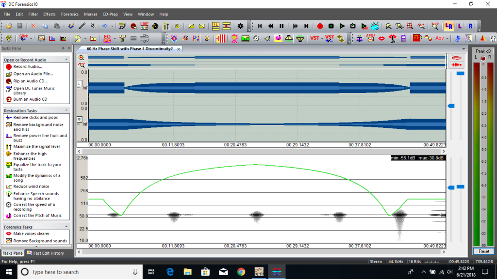

A useful “cousin” plot of the X-Y averaging display is the “View Channel Phase vs Time” function found under the Forensics menu. We recommend reading the section on the X-Y plotter to help gain some insight into all channel phase related phenomenon before using this feature. The channel phase vs time routine plots the average phase angle between the two audio channels vs time which can be useful in Forensics authentication applications. The vertical axis (Y) represents the average phase between two audio channels (with a span from 0 to 90 degrees) while the horizontal (X) axis represents time. The middle of the Y axis represents an average phase angle of 45 degrees. The intensity (Z Axis) of the green graph line is intensity modulated as a function of signal magnitude. This system requires a two–channel signal to perform its function and will not function with single channel signals. This plot overlies (on top of) the spectrogram and is shown via a green line. Sometimes, it may be found to be useful to bring up the X-Y plotter (View Menu) while using this tool since it also shows the instantaneous phase of the two audio channels thereby giving you additional information about the file being investigated.
Average Channel Phase vs Time Graph (green line)
Discontinuities in the phase vs time plot may be worthy of further inspection. The graph may relate to the coherence of the two signals or they could indicate a possible edit in the stereo file or people changing position in the venue or even a movement of the position of the recorder. When using this in Classic Edit mode, you can see the time domain signal directly above the phase vs time plot and correlate discontinuities directly to the time domain. You can zoom-in onto the time domain graph or the Channel Phase Graph where these anomalies occur and study those areas of the file for potential authentication related issues. The two views will track each other via the synchronization function, so you can zoom-in or zoom-out via either display.

The following are descriptions both of the phase vs. time demo files:
- Phase vs time Speech Demo
- 60 Hz Phase Shift Demo
