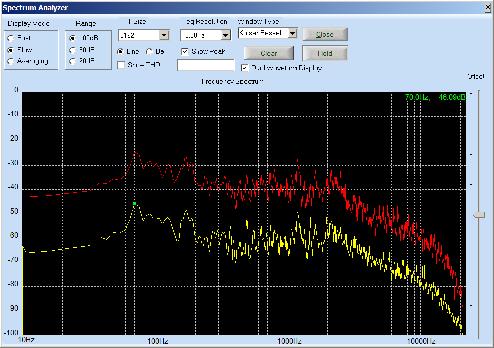

    The Spectrum Analyzer command in DCArt10 brings up the floating and user sizable Standard Precision Spectrum Analyzer. The Spectrum Analyzer is capable of resolving frequency increments as small as 0.02 Hz on 44.1 KHz sample rate files when it is set appropriately. This Analyzer can be used with any of the filters or effects. It is connected to the output of the filter or effect, so that you can see, in the frequency domain, how you have affected the file. If you want to compare the output of the filter or effect to the input, use the Bypass function on the filter or effect window. Since the Diamond Cut Spectrum Analyzer utilizes constant Hertz per frequency band, it will display white noise as a flat, horizontal line. This is unlike octave weighted real time audio analyzers in which white noise produces a diagonal, positive sloped line, and pink noise produces a flat horizontal line. Conversely, pink noise displayed on the Diamond Cut Spectrum Analyzer will be displayed as a negative sloped diagonal line. Normally, the Spectrum Analyzer displays the algebraic sum of the left and right channels. The Dual Waveform Display option will provide discrete displays for each channel. Keep in mind that the use of the Spectrum Analyzer will slow your system down slightly. Therefore, when you are done using it, shut it down.

    The Standard Precision Spectrum Analyzer
    The following displays are provided on the Spectrum Analyzer:
    • Frequency vs. Amplitude Graph: The vertical axis indicates 0 dB at the top and ranges down to -100 dB at the bottom by default. The amplitude range can be changed via the Amp Range control. The horizontal axis indicates frequencies from 10 Hz (left) to a little over 20 kHz (right).
    • Two digital readouts indicate the frequency and amplitude of signals feeding the Spectrum Analyzer. One signal is the peak value and the other is user defined.
    The following controls are provided:
    • Display Mode:
    • Fast: Shows the spectrum in almost real time.
    • Slow: Shows the spectrum with slower ballistics.
    • Averaging: On/Off: This allows the system to provide you with the average signal spectrum rather than in “Fast” real time display. The averaging time interval will be as long as the analyzer is left in operation or until the “Clear” button is activated. The looped play function is sometimes useful in conjunction with the Averaging function.
    • Dual Waveform Display: This checkbox allows you to view both the left and right channels simultaneously on the Spectrum Analyzer display provided that you are working with a stereo .wav file. The right channel information will be displayed in red while the left channel is displayed in yellow. If you operate this feature with a monophonic .wav file input, the display will be shown in yellow.
    • FFT Size: 11 selection alternatives (64, 128, 256, 512, 1,024, 2,048, 4,096, 8,192, 16,384, 32,768, & 65,536). This selection determines the frequency resolution of the spectrum analyzer. The higher the number selected, the better the frequency resolution of the display. The Forensics version extends the FFT Size range up to 131,072.
    • Range: (Amp Range) The Amplitude Range control scales the vertical axis to 150 dB, 100 dB, 50 dB, or 20 dB for full scale deflection. This feature along with the offset control allows you to hone in on a particular signal.
    • Hold Button: This is a "toggle" function and will allow you to freeze or un-freeze the spectral display update.
    • Clear Button: This clears the display. It is especially useful when using averaging mode so that you can clear the display after a long averaging interval, allowing you to move onto a new area of the Waveform to be averaged. Clearing the display will re-initiate the averaging process as well as clearing the display.
    • Show Peak Button: This feature will automatically find the peak amplitude signal and display its Frequency and Relative Amplitude value in the upper right hand corner of the Spectrum Display screen. The marker and display for this feature are red in color.
    • User Controlled Marker: You can place a marker anywhere you want on the spectral display by clicking the left mouse button on the signal that you are interested in measuring. To accomplish this, merely point the mouse cursor to the peak of interest and click the left mouse button. A magenta colored marker line will appear at that location and a yellow digital display of the frequency and relative amplitude of the signal that you pointed to will appear in the upper left hand corner of the spectral display. To read another value, merely click the mouse again after pointing to a new spectral line. The marker and the display will then be updated.
