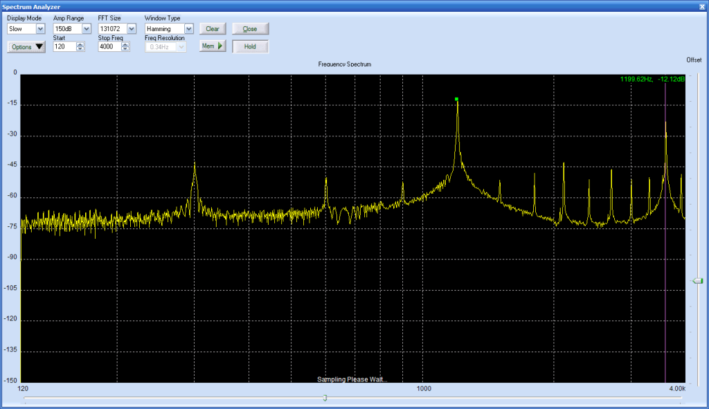

Point, Click and Measure
To measure the Amplitude and Frequency of any given spectral line or signal, just point your mouse at the signal of interest and left – mouse click. The two numeric values are then displayed in Yellow in the upper left hand corner of the Spectrum Analyzer. Its format is: Frequency in Hz, Level in dB (Hz, dB).

The first difference that you may note between the DCArt10 and the DC Forensics High Precision Spectrum Analyzer is the extensive list of functions provided under the drop-down menu on the left side of the system labeled “Options”. Clicking on this menu provides you with the following options from which to choose. Option Menu (Forensics Version)
- Show Peak Checkbox – Provides for the automatic measurement and display of the Peak Amplitude Signal level in dB and its Frequency. The two numeric values are shown in Green in the upper right hand corner of the Spectrum Analyzer. Its format is: Frequency in Hz, Level in dB. (Format is Hz, -dB.)
- Dual Waveform Display Checkbox – When this checkbox is not ticked off, the system displays the summed average of both the Left and Right channels. When it is checked, it provides you with the ability to discretely display the Left and Right channels. The Right channel information will be displayed with a Red trace while the Left channel is displayed in Green.
- Bar Graph Mode Checkbox – When this checkbox is unchecked, the system displays each data point with a line drawn in between. When it is checked, the data is represented in a bar graph format.
- Standard FFT Checkbox – This applies the number of bins (FFT Size / 2) to be distributed over the entire audio spectrum.
- Hi Precision FFT Checkbox – This mode allows the number of frequency bins to be applied strictly to the range (or span) of frequencies selected by the user. This mode effectively improves the Frequency resolution of the system when the range of frequencies selected is less than the entire audio spectrum.
- 10 Band Octave Analyzer Checkbox – This changes the mode of operation from an FFT Based system to an IIR based simulation of an Analog, Octave frequency weighted system (like an RTA).
- 30 Band Octave Analyzer Checkbox – This changes the mode of operation to an IIR based simulation of a 1/3rd Octave frequency weighted system like an RTA).
- Smooth Spectrum – This smooths the graphical display based on a set of frequency domain calculations using adjacent sides of a bin within an FFT.
Settings for High Accuracy Measurement of %THD with the Precision Spectrum Analyzer
Display Mode: Fast
FFT Size: 65,536
Start Frequency: 20 Hz
Stop Frequency: 20,000 Hz
Frequency Resolution: 0.67 Hz
Resolution Mode: Check “Standard FFT” in the Options Menu
Range: 150 dB
Display Mode: Bar or Line, your choice as found in the Options Menu
Window Type: Kaiser-Bessel
Show Peak: Check this checkbox in the Options Menu
Show THD: Check this checkbox in the Options Menu
