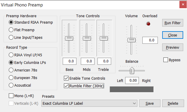

    The Diamond Cut Productions VPP has the ability to re-eq transfers made from RIAA or Flat to the early Columbia curve (and other EQ curves as well).
    Columbia records played on an RIAA based system sound substantially different than those transferred or played using the Columbia curve. The Virtual Phono Preamp) VPP has the ability to re-eq the transfer making it sound the way that the Columbia recording engineers had intended them to sound.

        For 78s, there were only two curves, both being low frequency turnover curves (American 78s were 500 Hz and Euro 78s were 250 Hz). There may have been other 78 curves, but they were not standard. Once the LP era came in, HF rolloff (de-emphasis) was added for LPs; many variants existed up until around 1954 or 1955. You can find the LP variants under the presets section of the Virtual Phone Preamp (VVP). Here is a screen shot a few of the presets for non-standard LP eq curves:

          Here is another view of the alternate LP curves available. Scroll the presets list to see all of them.
