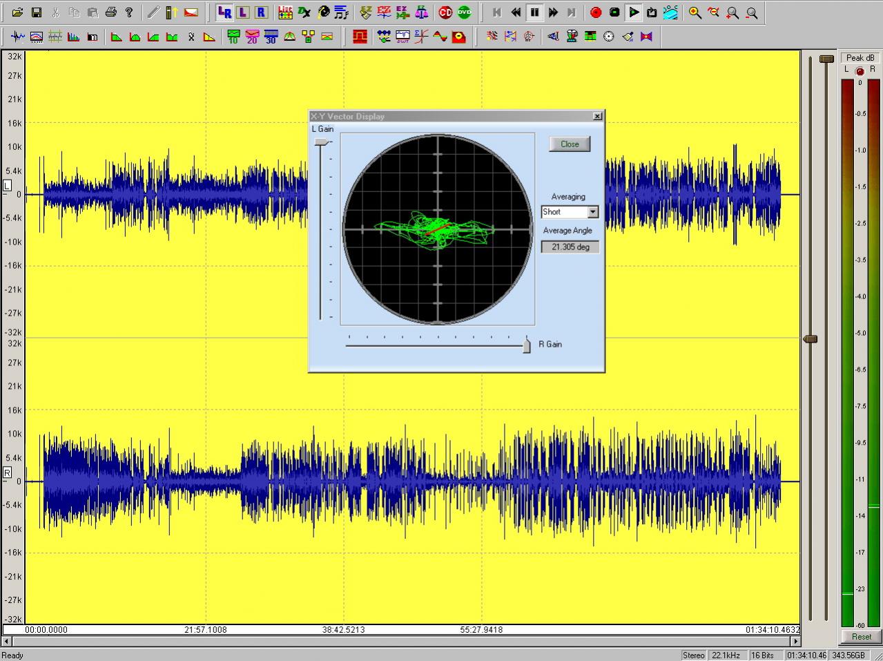

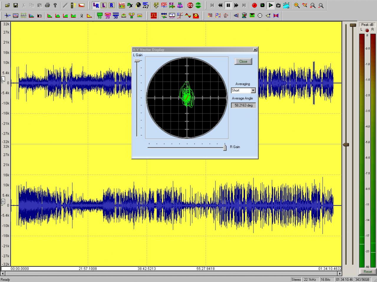

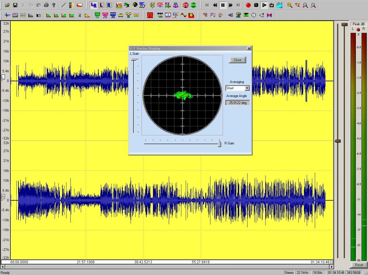

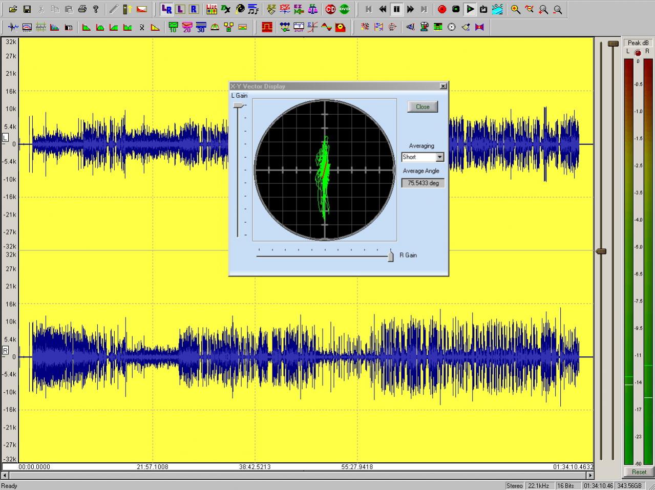

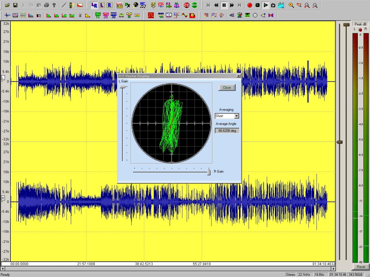

              Below are some random screenshots taken from one of my suspect files.
                I think that is a stereo signal - - - the average angle is changing alot which is a hint and the elipses are of variable foci. If you want to send me a short sample, I can analyze it myself and render my opinion about it. Send 10 secs of the file to me at
                dctools@aol.com.
                I will not get to it for a day or so as it is a holiday, but I will do it this week.
                  Thanks Craig, I appreciate that. I've sent you a short clip.
