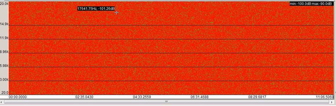

    Just did it.. the file is completely quiet and empty. I added 20dB to the sound (incresd gain) and still is quiet. Then I added 20dB more and there's something there... A whole lot of irritating noise.

          Here's a picture of the difference, when I add 40dB of gain to the file. Just random noise.

              Dan's results make sense. Bit depth fundamentally sets signal to noise ratio. 16 bit is (IIRC) theoretically about 96 db; 24 bit is well into the 100s. Of course, the sound source (if it's analog) will do worse than that - 60-70 db is doing pretty good for a used record or old non-master tape. So if he originally got silence (noise floor around -100 db) and added 40, he got it up to 60 db which is audible but not bad, again, for older analog sources.
